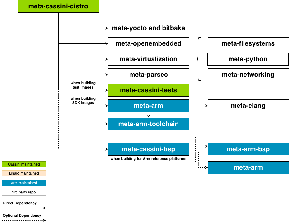

Layer Dependency Overview
The following diagram illustrates the layers which are integrated by the Cassini project, which are further expanded on below. The layer revisions are related to the Cassini v2.3.0 release.
../_images/cassini_layers_deps.png
Cassini distribution depends on the following layer dependency sources:
